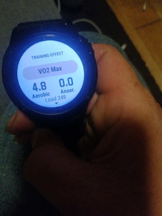

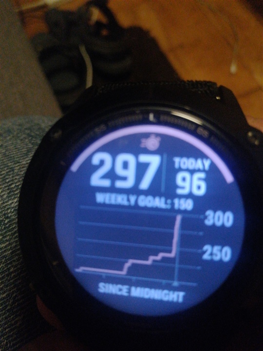

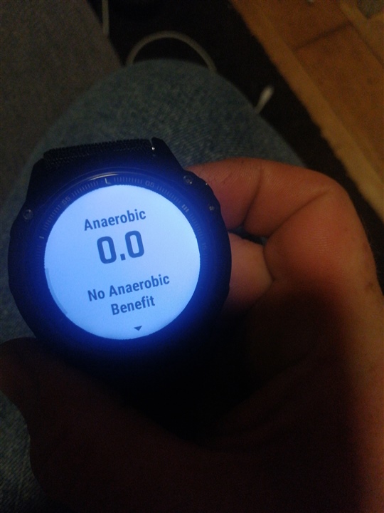

My Fenix 6 has stopped recording anaerobic work and I never get a performance condition. The widget never come up anymore and even with a tough workout in all zones my training load is in 20s and never any anaerobic number! I use a power meter and heart rate strap and used to work fine but suddenly every ride puts me in recovery and my load is just dropping off. Vo2 won't change either and my rest should always be way more than it says.
Any ideas as to why? I can't for the life of me figure this out. Heart rate zones are the same and power zones are.

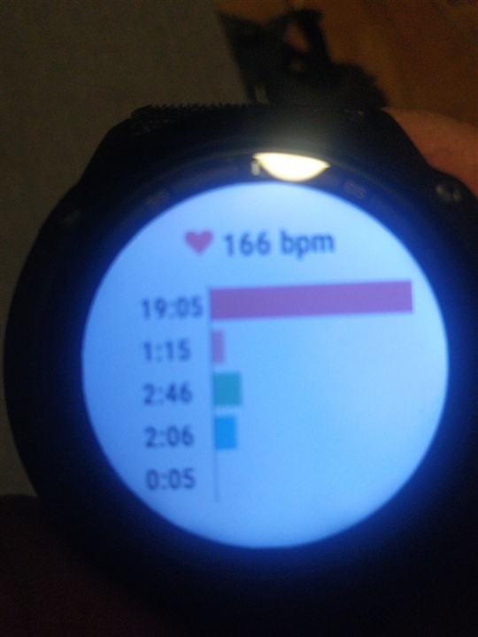

  • Both indoor and outdoor. Before the 19.20 upgrade I always had the condition status. Since then nothing.  See picture how it sopped, till then I had it every time I trained.
