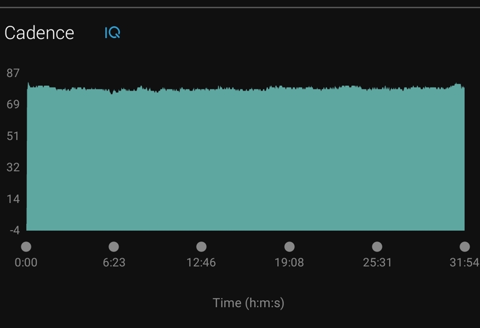

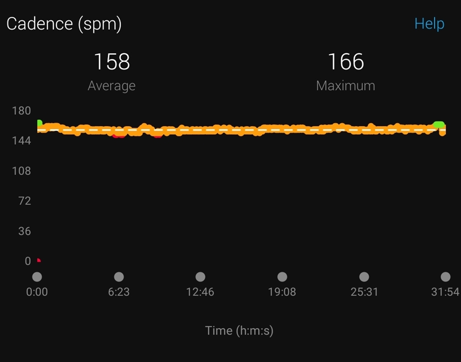

I have Fenix 6s Pro, and recently (most likely after 19.20 update) I have noticed that during running acitvities the watch shows cadence as half of what it usually shows. For example it shows 85 instead of usual 170. However after completing the activity, it shows correct cadence in garmin connect app. I have noticed this both with and without the HRM chest strap. Did anyone else also notice something similar?

  • This thread should be move to the CIQ Bugs however would correct but where in the ConnectIQ API document mentions the Activity.Info.currentCadence is 1/2 the actual value.
    The Activity.Info.currentCadence is providing the wrong value 1/2 the value that is available to the Sensor.Info.Cadence.
    Sensor.Info.Cadence is correct.
     The CIQ libraries are separated from the the watch firmware, so what you would observe in the base datafields would be different than the CIQ datafields.

  • Same issue here. The cadence is halved on the watch while running, but it shows up correctly (as least seems to be) in Garmin Connection. I assume its an app / dev issue. I hope there will be updates from developers soon to resolve it.
  • This is a bug in the FW, has been ID'ed as such and allready fixed in the 6.33 beta firmware for the va4 and venu.
    From the va4/6.33 change log:
    • Fixed an issue were cadence values were halved in Connect IQ data fields
    Please don't blame the CIQ app developers, as it's not their bug.
