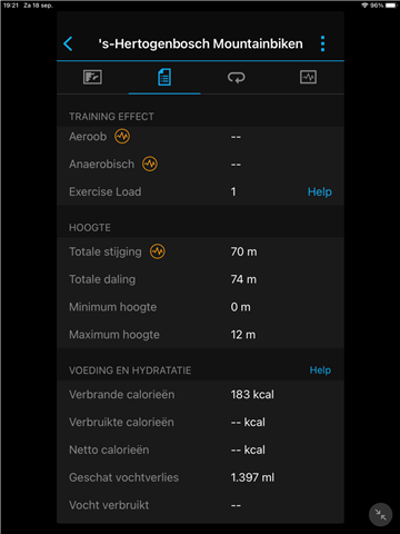

When I do my usual training suddenly my calories are rest level. 150 cal. In stead of 1600 kcal. Also my aerobe and anaerobe levels are non and I have no training minutes…..
But i do have the map, the spead, the hardrate, hight, temperature…..    seams like no calculation ?

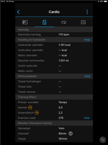

  •   Garmin - chris I have the following facts for you.   Crosfit cardio profile works fine, no difference. High values on aerobe and non aeroob and effort numbers. I have done this training several times so no problem. I have also done a relaxed walking track that I done several times. Al the figures are the same.
    But today again it went wrong on MTB.    De  typically no figures on aeroob and an aeroob. Calories should be at least 1000kcal, the effort should be 250. Etc.  In conclusion biking and moutainbiking profiles have bugs!  How can I revert to 16.70, or is there a patch?  Tomorrow I wil use my old tom tom spark 3 alongside garmin fenix 6X…….
