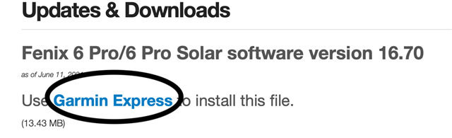

I know that. However in the past Garmin was at the same time providing a link and those that didn't want to wait until Connect Express offers the update could get the download and install it the way we install the beta. Now they are waiting to provide that link, but they still do it as you can tell with the link to 16.70 that is available here https://www8.garmin.com/support/download_details.jsp?id=15031 so this is no technical limitation, simply a policy that they seem to have changed. I think their previous policy was better - wait for the easy process to trigger if you like and bother with following the manual download process if you prefer.
Did they? I've been a Fenix user since 2015 and as far as I can remember there never are any links for direct download to the official/public releases. Only for beta and release candidates.
That is only the release notes.
