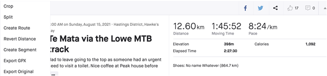

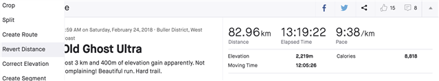

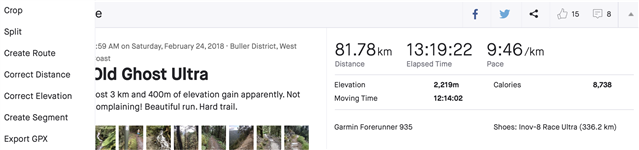

  • The reality is that anything within 10% on heavily forested trails with lots of tight turns is not an unreasonable outcome from a wrist worn GPS watch.
    That 10% is a difference between two distances recorded by the same device on the same activity..Why these two distances are not the same?
  • At the same time?
    There are so many variables involved that it’s just not that easy to make any assumptions about where the problem (if any) lies. I accept that might be taken as a cop out but unfortunately there is no easy answer. One persons guess is as good as any other but there is still a fundamental inaccuracy with GPS. However, I still maintain that it is has gotten better over the years and not worsened as others believe.
