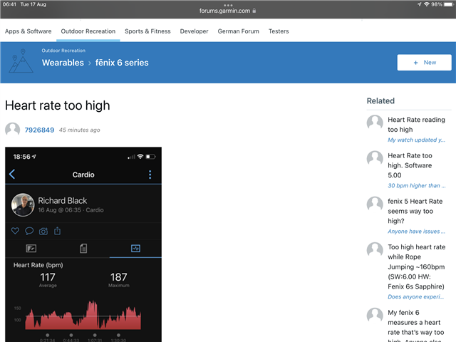

When exercising fenix 6 pro records falsely high heart rate Today’s easy going session had me at 187 max. My Personal max is 160 as use Myzone chest HR Monitor. All firmware up to date

I am assuming it is the block of high HR from about 50 mins to 1hr10 that is of concern?
The usual cause of high HR while running is "cadence lock" where the watch moves on your wrist allowing external light to enter the sensor in a rhythmic way with each arm swing. The sensor picks up on this external light rather than your HR, and a recorded heart rate in the 170-180 range is typical of this.
To prevent this, the band should be pretty snug on your wrist, and the watch positioned well away from your wrist bone - this ensures a better seal against external light. Personally, I find I have to have the band 1-2 notches tighter for accurate HR while running, than I do for 24/7 monitoring.

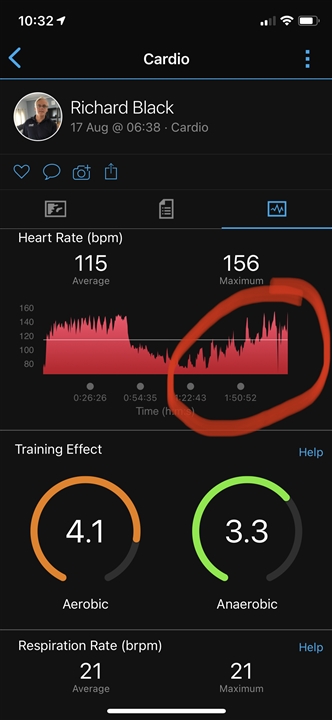

Hi, yes that's where the spikes are.. (about 1 hour) i had read previous posts and do wear the watch tight.. during todays WOD i noticed the same event so switched the watch over to my left wrist (including trying on the inside of the wrist like during a kettle bell push press).. the readings were still recording higher BPM! My myzone recorded 70 bpm at the same time the Garmin 130 ish.. undoing the strap and holding the watch onto my forearm (right up towards the elbow) seemed to restore the correct reading.. why would both left and right wrist have the same anomaly? The attached pic shows where the error occurred..

So yesterday (during an interval rest) I had the same problem.. you can see the Garmin was reporting about 110 BPM where as my zone was 55bpm. The watch was tight and snug with no daylight getting around to the LED’s. any suggestions on this please?
