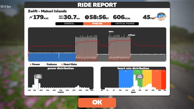

  • I have a Neo 2 and can perform 10 second sprintervals in erg mode and hit my targets, but there is lag in the increasing resistance, overshoot of peak power, and then wobbly averaging over the 10 seconds to make the numbers. The lag at the start is matched by a corresponding lag at the end of the interval, so overall the sprint duration is about right, even though it lags the workout by a couple of seconds.
    For a less capable trainer it might be better to forget erg and simply smash the pedals for a true "sprint" for 10 seconds and not worry about the sprint power number too much.
    Here is an example of a Garmin 10 second sprinterval workout executed in Zwift.
    By the way, the workout is the workout. It is not for the watch to second guess the trainer abilities and adjust the workout. Would it be any different with Trainer Road, Sufferfest etc? I don't use them, but I imagine not. If you really want to compensate for trainer shortcomings then you could always build your own custom sprint workouts.
