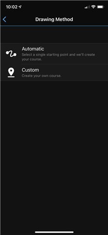

  • In GCM (iPhone at least) Training - Courses - Create Course
    Then save the course and send it to your watch.

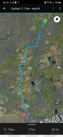

  • You can create a course on Garmin Connect Mobile and send it to the watch over Bluetooth. I just tried a simple route with a start and end point and let GCM plot the route between the two. You can plot intermediate points too, if you want to fine tune the course.
    Alternatively you can use Garmin Connect Web to plan your route and it will appear in GCM to send to your watch.
