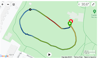

  • on the basis of this crazy GPS track, i'm actually now wondering if some other calculating method is used (i did wait until i got a green GPS lock too before i started recording my walk)
  • btw this is a 400m running track (supposedly)

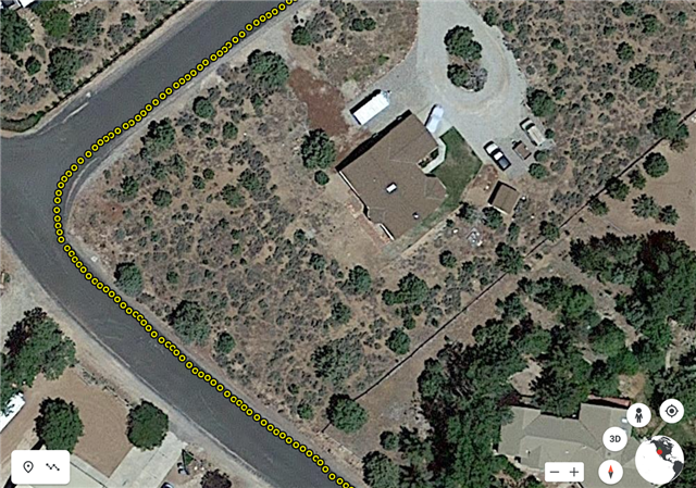

    On the contrary, I believe my fenix 6xPro does indeed "produce" and record each trackpoint individually.  I have my GPS Data Recording set to record Every Second.  Here is a portion of a Walking activity I did recently exported to Google Earth - notice each trackpoint (the yellow circles) appear every second, and no "cutting heavily into corners" is evident:
    Note: I was walking at about 19:44 min/mile on the left side of the street - looks like very little fitering or interpolation to me.
    Perhaps you have Data Recording set to Smart or even UltraTrac and are not recording every data point?

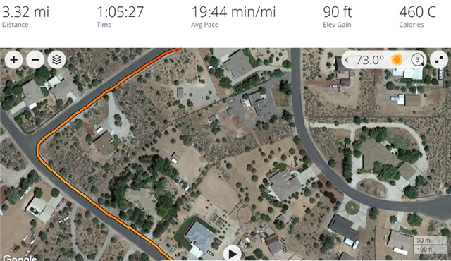

    Here's what that part of the activity looks like in Garmin Connect:
    It's satisfying to see a good correlation between the map/track in Connect and the map/track in Google Earth.
