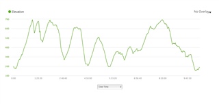

  • One way to see if there's glitches is look at the elevation profile and see how "smooth" it is. So for example, for that 2574m - I get a very smooth profile, as expected. For the shorter ones, they do tend to be a little spikier but not much.
    But definitely switching on calibrating the altimeter at the beginning helps. It may be worth, for runs less than ~1hr where weather conditions change will be minimised (and hence, a change in ambient atmospheric pressure) experimenting with the barometer settings (changing it from calibrating altimeters to just barometer only) and seeing what happens.
