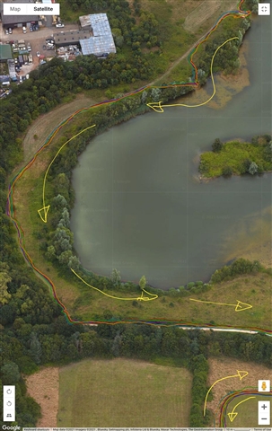

    EDIT : I now have five days of data out of the past six days for the same walk. Separation between tracks is rarely more than 5m in total, or +/- 2.5m - for walking the dog. This seems very reasonable performance to me. Here is a more tightly zoomed example of all five tracks. Click the image and zoom for a better view. Direction of travel is marked with yellow arrows. In the bottom right corner I retraced my steps, so this is ten tracks in total.

  • Here are my tracks from three separate days of dog walk overlaid on each other. You will note that by and large the tracks are quite consistent, with no massive deviations etc.. This is with my 6X Pro Solar.
    I honestly don't think anyone can tell anything about accuracy by posting a birdeye view of a map, pretty much any track looks great zoomed out at 1:100m resolution (or whatever the scale is).
    Not commenting one way or the other about the accuracy, but as GPS is usually within 5 meter accuracy, maps should be posted at that resolution if you want to comment on accuracy (or otherwise)

  • Click the map image and zoom in (on something larger than a phone screen maybe). There is sufficient detail IMHO. You can use the cars for an idea of scale.
    Most of the tracks on this route are between 2-3m wide, but familiarity (more than a decade) and the intent to compare tracks means I retread the same path to within +/- 30cm almost 100%.
    I also favour walking to the right of the path, placing the watch rather then me closer to the centre line. It is quite easy to spot my direction of travel (usually) based on the left hand offset.
    If you wish to see greater detail you can find the analysis here and zoom as much as you like.....
    analyze.dcrainmaker.com/
