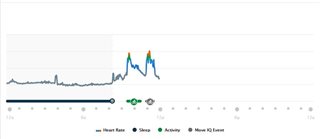

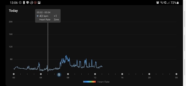

  • Something is wrong with this new Firstbeat stuff... Both stress and RHR figures are all over the place...
  • RHR is nothing to do with Firstbeat - that's a standard non-proprietary metric.
    However if you think your device is not logging your heart rate correctly, it would stand to reason that metrics derived from that would also be wrong.
    Also looking at the vertical axis of the scale of the pictures you have posted, what looks like huge up and down swings actually are not.

  • wondering if you are permanently sitting, doing nothing as your HRV/stress levels are virtaully none existant, hence barely any drain. Looking at your HR, you barely go above 80 and spend what looks like most of the time on the low end of what is considered normal - 60bpm. Must be super fit and or not wearing your watch properly or issues with sensor. Is your HR normally so low... What does your RHR trend show (Connect website can show this trend).
