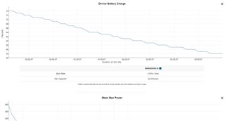

    • Ride Time 6:59:54
    • Total Time 8:39:41
    • from 100% to 37

    Ride Time: 7:52:03
    Total Time: 8:31:39
    Battery Consumption: 100% to 70%
