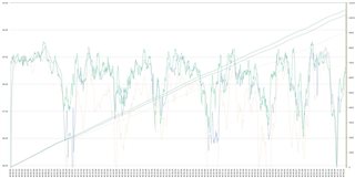

I am analyzing my own .FIT files from my Garmin Fenix 6X Pro Solar Titanium and I have noticed that there are two different entries for enhanced_speed[m/s] and they differs quite a lot. The first is record.enhanced_speed[m/s] and the second is gps_metadata.enhanced_speed[m/s].
record.enhanced_speed[m/s] seems to be the data which is used for Speed and Pace in the watch data fields and also for the diagrams in Garmin Connect mobile app and web.
But, what is gps_metadata.enhanced_speed[m/s] used for? The data in gps_metadata.enhanced_speed[m/s] seems real weird... really low and differs a lot compared to real speed. The record.enhanced_speed[m/s] is also low and does not compare to real speed but its better than the gps_metadata.enhanced_speed[m/s].
I'm having big problems with the Speed and Pace on the device and it seems to be related to this in some way. I know that the accelerometer is involved in the Speed and Pace and that makes the problems even worse.
Anyone who can explain the two different enhanced_speed[m/s] for me?
