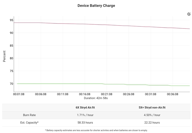

  • I have some recent stats from a run with my 6X Pro Solar and 5X+, both connected to a Stryd footpod and HRM-PRO strap. The run wasn't really long enough to obtain rock solid battery data, but the numbers here are consistent with the generally poor performance of 5X+ battery vs 6XProSo. I imagine your 5+ would be even worse than my 5X+.
    This is with smartwatch connections to my phone enabled on the 6X. Not sure about the 5X+. It certainly had Bluetooth connection enabled, for syncing etc, but possibly not for notifications.
    GPS is going to be the battery hog. Indoor cycling with power, cadence, speed, but no GPS, drops at 0.57% per hour based on stats from a 108 minute ride today.
    I would imagine the drain rate to be the same for running and biking outdoors with GPS. Basically a fully charged watch is good for 60 hours with GPS according to the specs. My experience seems in line with that.

    So for now, I'll work under the assumption that there is roughly a factor of 3 between 6x and 5x+. If that holds true for 6 vs. 5+ then renting a 6 Pro would be more than enough (I have small wrist, the 6x would look crazy on me).
  • Excuse me. How can I get the graph like youn attached about the battery capacity estimate curve? By GCM or GE?
  • The graph is produced from the DCRainmaker Analyzer. The data must be embedded in the fit files. You just need the right tool to read it.
