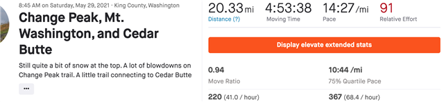

    I correct the distance in Strava. On activity web page there is a small (?) link next to the distance. Clicking that link forces Strava to re-evaluate the GPS track and get the distance from it rather than use the device reported distance.

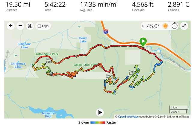

    For example, here is the last outing in the local mountains, as shown in Garmin Connect:
    Here is the same activity on Strava, after applying distance correction:
    All of the 0.83 mile difference comes from the switchbacky part of the run.

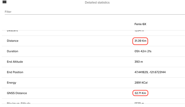

    Here is a screenshot from the same activity loaded into http://quantified-self.io - it shows both distances on the same screen (highlighted by me):
    32.71 km is 20.34 miles, so quantified-self agrees with Strava on this one.

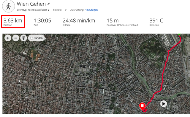

    Here is an example without any export to Strava or any other platform. I exported the activity (a city walk) as GPX from Connect ( saved on my computer). Then I imported this GPX file back into Connect.
    Garmin itself turns the actual (too short) distance of 3.63Km into the correct distance of 4.06Km.

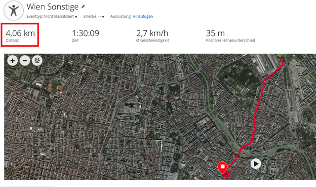

    above activity saved as GPX on computer and imported back into Connect :
    This is the behavior of the Garmin conversion from FIT to GPX. Although the FIT file already contains all GPS position points, the FIT file results in a too short distance. This is converted into the correct distance by recalculation during the conversion to GPX.
    The 3.63 km is also the distance displayed on the watch itself. However, it is too short and does not correspond to reality. Oddly enough, older and cheaper Garmin models seem to do it right. THAT is what amazes me.
