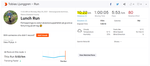

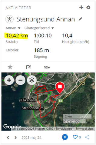

    Which is closest to the truth, 10.22 or 10.42? I guess that 99% would argue it is 10.42 since that would make you a quicker runner and we all know Fenix6 distance is always to short...
    10.22 is from a calibrated Stryd and is probably as close as possible to the truth. Before I started to use a Stryd my Fenix 6 always got about 10.32. Imagine a F6 that overestimates the distance?!? :-)
