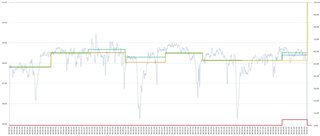

  • And here I have added a green line that shows "Average Lap Pace" based on GPS data (no accelerometer involved). It matches the built-in "Average Lap Pace" really good. Blue (the one based on "Pace") is way off from time to time.
  • Yes, the data is extracted from the .FIT file and Auto Lap Distance was 200 meters to get better comparisons. Yeah, they should match really good but they don't. Due to the buggy "Pace".
    I wish it was possible to configure the Auto Lap Distance to 100 meters but that is not possible at the moment. I have sent in a suggestion to Garmin for that.

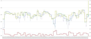

  • I have now looked at your .FIT file which used Stryd for Speed and Distance. The "Average Lap Pace" for each 1 km was identical (blue line is hidden behind the yellow line) to the calculated "Average Lap Pace" based on the "Pace". So the Stryd clearly can match those two data types.
    When I compared with an own calculation of the "Average Lap Pace" based on GPS data only (green line) I see some differences at km 3 and 4. Stryd measured a slower Pace there than GPS. Otherwise it looks good!
    But it would be better results in the comparison with a shorter Auto Lap Distance. And maybe only measure Speed/Pace by the Stryd and use the watch for measuring the Distance.

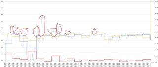

  • I did a short walk this morning and tested to manipulate the Pace just by using more arm force while walking. Success. It works, no need to increase cadence. More arm force gives a faster Pace.
    Also interesting to see that the algorithm in the watch seems to compensate for the manipulations afterwards.
