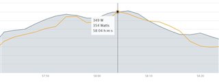

  • I agree Philip, although both of my Styds come up short, not long. Actually neither Stryd agrees with each other, 2% distance difference between the 2 over a 10k and even power is different. I've worn 2 Stryds during 1 run on several occasions and this is repeatable.
    Try contacting Stryd support - you will never meet a more arrogant company - they will claim EVERYTHING else is inaccurate - GPS? We are better. Measured track? - measuring wheels can be wrong..... 400mm track...400m tracks can be inaccurate. Treadmill - treadmills are inaccurate. When you present data from TWO Stryds on one run (either worn on either same shoe, or different shoe), so BOTH clearly cannot be accurate when both dis-agree with each other, it's amusing the logic bending they come up with. It's like a parallel universe in Stryd-land.
