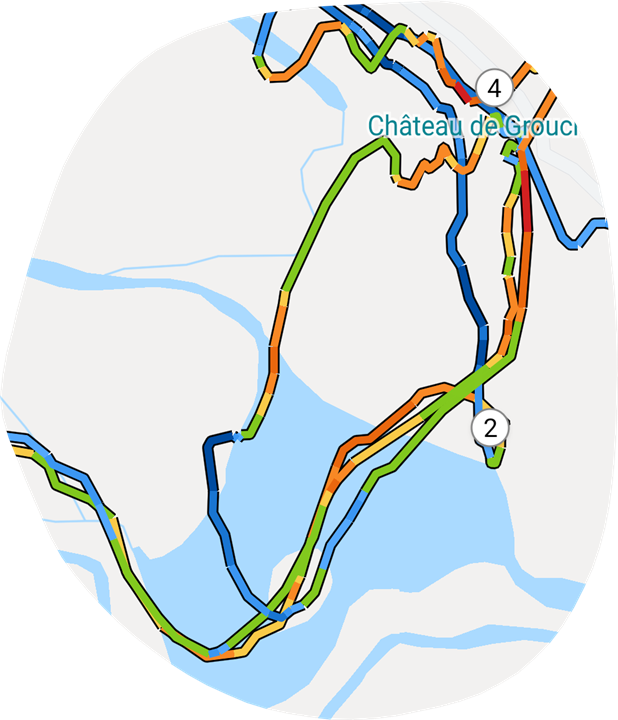

I have a fenix 6 pro and i run 2 twice per week with it.
The gps accurate is not very good. For instance, my old huawei watch was better than my expensive fenix 6.
I m desapointed because i don't no why. For instance look my run. If you look well i can walk on water, like jesus ! There is about 5 to 10 meter of shift. It is too much.
Do you have a solution ?
Many thanks all.(sorry for my english speeking)
  • I see a lot of forest in that area around Château de Grouchy - do you start under trees? Do you wait some time without movement before starting to get proper satellite signals?
  • Hi
    Yes you re right, there are some trees, but I have waited maybe 3 or 5 minutes before starting. However not a lot trees it should be good. I hadbo lot of watches and this accurate is my worst. I thought that my garmin fenix could be best of others ! Do you agree with that ?
  • I'd say this is not normal. I just checked some of my recordings in forests and it was much better. Do you cover the fenix with clothes?

  • 5-10 meters really isn't that substantial. All GPS watches (including your old Huawei) are only accurate to within, at best, 5 meters anyways.
    That said, the fact that the entire track is shifted indicates to me that there's either some GPS RF reflection issue happening (hills, buildings, etc), or your GPS file is outdated, or you aren't using the optimal GPS setting for your area, or you're not "soaking" the GPS before you start your activity.

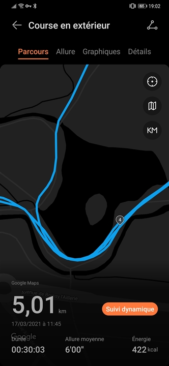

  • Hi
    Thanks for your reply.
    So you re certainly right but i think the fenix 6 pro automatic download the gps file by wifi, isnt it ? Or how can i update my gps file ?
    Look my huawei watch for the same run. i m not walk on water in this case :)
  • Hi
    i walk on the water again ! Very desapointed grrrrr
  • What is the best gps accurate configuration.
    Gps only
    Gps + Galileo
    Gps + glonass
    Ultratrack
  • It depends. But it is not ultratrack, that one is for battery saving purposes only and will give you very bad accuracy.
