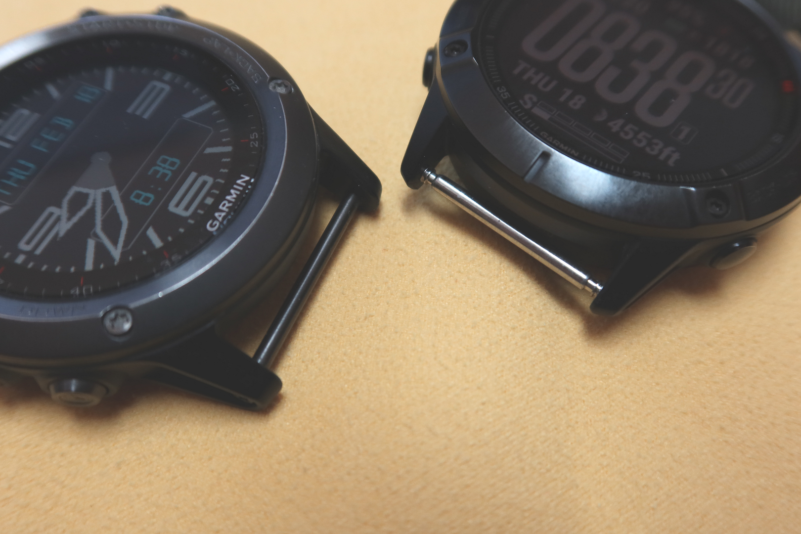

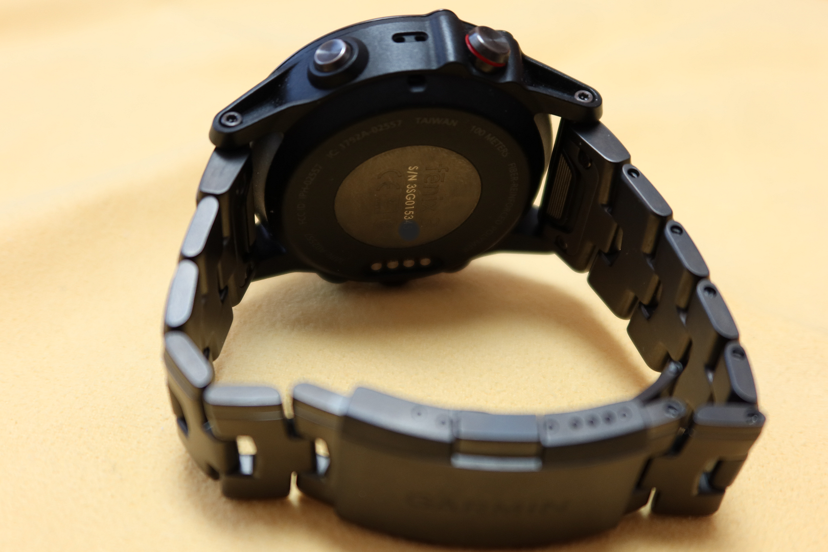

  • Hi, I'm still using a Fenix 3 quite happily but I'd really like the vented titanium strap on it, which comes with the Fenix 6x Pro. Does anyone know if this would fit the 3? Looks like the widths are identical but I can't tell if they made any crucial changes that would negate being able to fit it to the 3, like making the pins thicker/thinner or something. Hoping someone who has the 6 still has the 3 kicking around in a drawer and can physically check it! Thanks in advance.
    As is the case with ALL 26mm QuickFit straps, the vented Titanium bracelet is a perfect fit on the fenix 3:
    HTH
  • Thanks, Nemo. You said the 6X has switched to spring bars, I had the 5 and the Chronos for a while which had spring bars, and they were much thinner than the 3 bars. I don't know the technical term for them but the bars with a pin that you could pull to release the wacth strap from the watch, it was different from the quick release straps that you pull the catch under the strap. Does this mean the 6x bars are now thinner than the Fenix 3 bars?
    The fixed fenix 3 bars are the same diameter as the spring bars on the fenix 6X - both are 2.3mm.
    Also, the fenix 6 sring bars are not the "quick release" type with a pin, they are normal style spring bars, just a little thicker than a generally available 26mm spring bar.
    HTH

  • Thanks very much Gaijin. The phots really help too.
