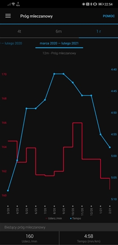

I Remember My Readings of LT on 166bpm/ 4.41min/km. When I was doing 10K Plan with Garmin Coach my LT readings was decreasing leaving it at 161bpm/ 4.56min/km

  • It works, but only until you are overtrained. This was my issue with Garmin coach. My training plan was to go with intervals with pace that was to hard for me. Every 800m I was ending with almost max HR. For few weeks my LT was increasing, but then it drasticly decreased.
    You can see here, I started my plan in september.
    Once a week it can be fine, but when you have more training days with High aerobic, you will not re over and LT will be decreasing.
