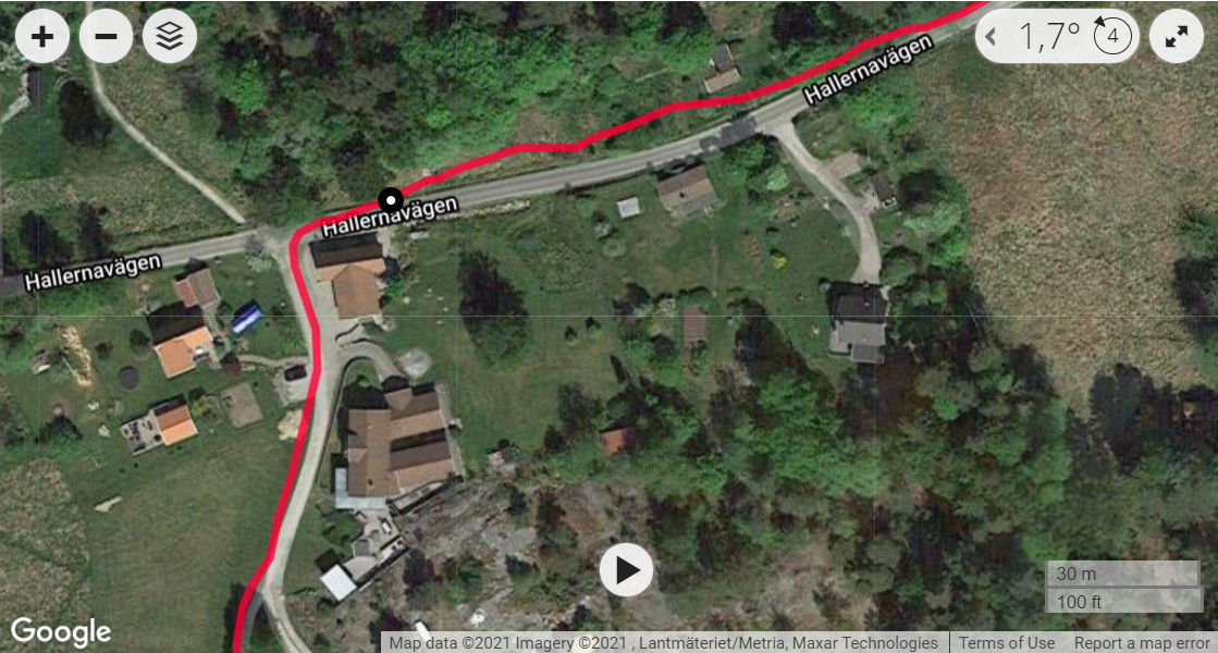

    Finally, make sure you use a good map source. I've posted examples of this before and here is an example of yesterday's lunch walk:
    According to Strava (Mapbox) I walked through the house but according to Garmin Connect (Google) it was pretty much spot on. Is Google always better? No but at this specific spot it looks better...
