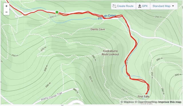

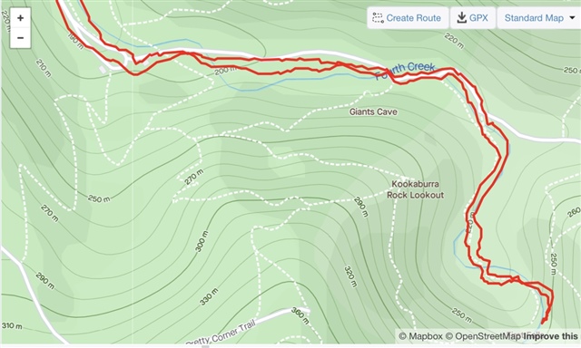

  • This is the variance that I normally see with the fenix 6x compared to something as basic as my Galaxy S9 running Strava. I really think a dedicated, flagship GPS sports watch from a global leader in GPS should do better tbh. I started the phone late and it was in my pocket the whole time so had no view of the clear blue sky but still performed noticeably better.
    Fenix 6x Pro
    Galaxy S9
    Your phone is far from being "something as basic".  It's no surprise your phone tracks better. It has a much larger antenna, it isn't moving that much (unless you're carrying it in your hand) and has the benefit of using cellular towers to triangulate your location along with GPS.  Compare that to the small antenna on a moving wrist and it's easy to see why there's a difference.
  • There is zero cell service for the majority of that walk.
  • Former Member
    0 Former Member over 4 years ago in reply to Tim_B_
    And......?  This doesn't dismiss the antenna size and movement.
  • Well...... you mentioned the ability to use cellular towers to triangulate movement, I was pointing out that there is no service in this area so it’s not a factor.
  • Former Member
    The use of cell towers is just one factor and is irrelevant in your case if you had a no cell service.  You failed to address the other factors.  The larger antenna in your cell phone and the fact you said your phone was in your pocket resulting in less movement and better reception still explains the difference in your results.
  • Everything’s better in New Zealand than in the West Island LOL!
