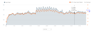

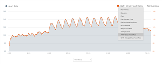

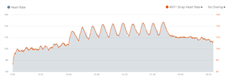

You can now record the activity and it will display the heart rate from both the OHR sensor and your chest strap at the same time as well as record the data. You can observe the data while recording the activity, and view the data in the workout after for both. You can do an overlay of the two graphs to compare the differences as shown below.

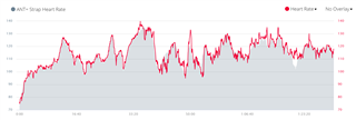

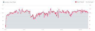

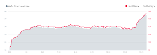

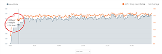

Here are 4 workouts I have done doing this comparison....
I am posting this because of some of the posts concerning heart rate issues with the fenix 6. Mine seems pretty spot on for the most part which makes me pretty confident in it.
