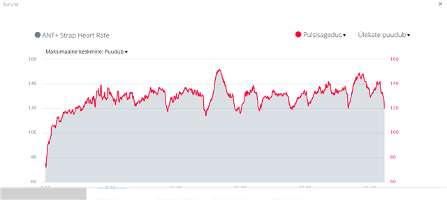

Here is an example of a recent easy run.  I used a data field that recorded the HRM Run data along with the watch HRM.
Here the watch says I maxed out at 186 BPM (that's higher than I can get if I'm sprinting 800 meter repeats or 5k races). According to this I'm overreaching and in zone 5.  Not true - it was an easy run and I was talking the entire time.
Watch HRM
Same run as recorded by the strap.  I never got much above 160 and that was only briefly as I ran up a dangerous hill (because getting run over by a large truck doesn't sound like much fun)
HRM Run HR
I'm not sure what to do next.  The watch is not lose on my wrist.  It feels the same as my 5x did.

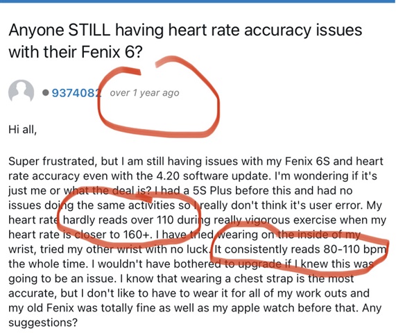

  • Similar issue here:
    Upgraded last week to a 6X Saphire from my 5X.
    OHR is unusable when I‘m performing activities with hiking or ski poles.
    As soon I even only hold a hiking pole in the hand where my 6X is worn I won’t reach HRs above 110bpm.
    When I take the poles on the other hand HR gets into normal rates again.
    Same issue on Backcountry Skiining activity where I use Ski poles to climb a mountain.
    Never had similar issues with my 5X the last 3 years.
    Seems 6X was a step back OHR sensor wise.
    Is that a know issue?

    forums.garmin.com/.../anyone-still-having-heart-rate-accuracy-issues-with-their-fenix-6
