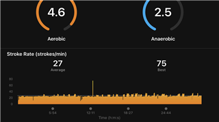

    I'll let Rick answer for himself, but in my case I certainly do get stroke info in both GCM and GCW.  Here's a link to a test row I did a while ago that shows all the info: Test Row on GCW fenix 6xPro indoor Row App
    And here's a screenshot of the page that gives the stroke summary data on GCM for that test row:

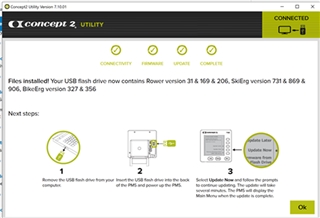

    I have an older PM5, so the latest software for mine is 31:
    If you have a newer PM5, you may need software version 169 or 206:
    HTH

    Here's the stroke rate graph on GCM:
