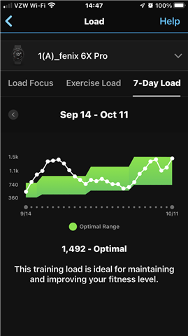

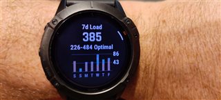

    I think Chris, who manages this part, requested screenshots, so I am uploading mine here.fenix 6Android AppWeb App
