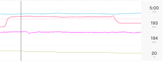

Sometimes the watch starts to display/record what seems to be a cadence from the RD Pod instead of the HR readings.
The problem seems to be the same, regardless of if the strap is connected via Ant+ or BLE.
Here is a recent example activity, the issue starts at 2:53: https://connect.garmin.com/modern/activity/5836129497
It can't be the "cadence lock", since I am not using the wrist OHR and the issue occurs even in the "jacket mode" which should disable the OHR completely.

There is a problem with the Wahoo TICKR 2 (WFBTHR04) HR strap not the Fenix 6. The strap has an issue which is best described as the "cadence lock".
Thorough electrode wetting with water or gel should hopefully help with that.
More info here: https://www.dcrainmaker.com/2010/04/troubleshooting-your-heart-rate.html
