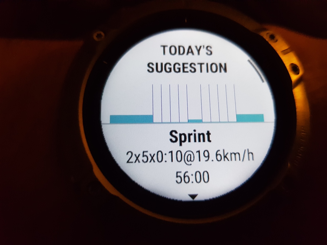

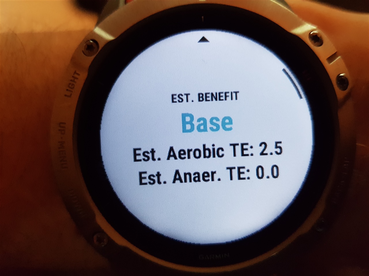

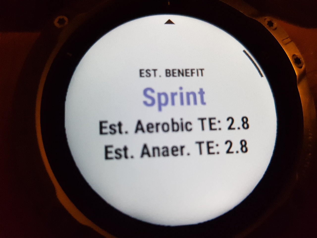

Today I tried to follow the suggested workout which was a Sprint workout called "3x3x0:[email protected]/h 55:00". Se picture:

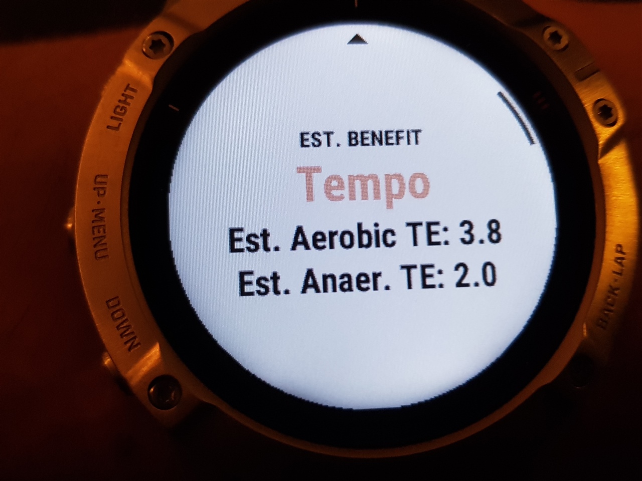

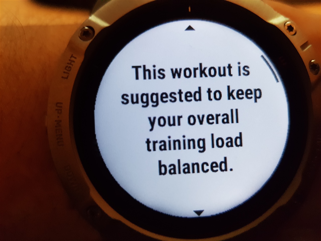

The estimated benefit was like this:

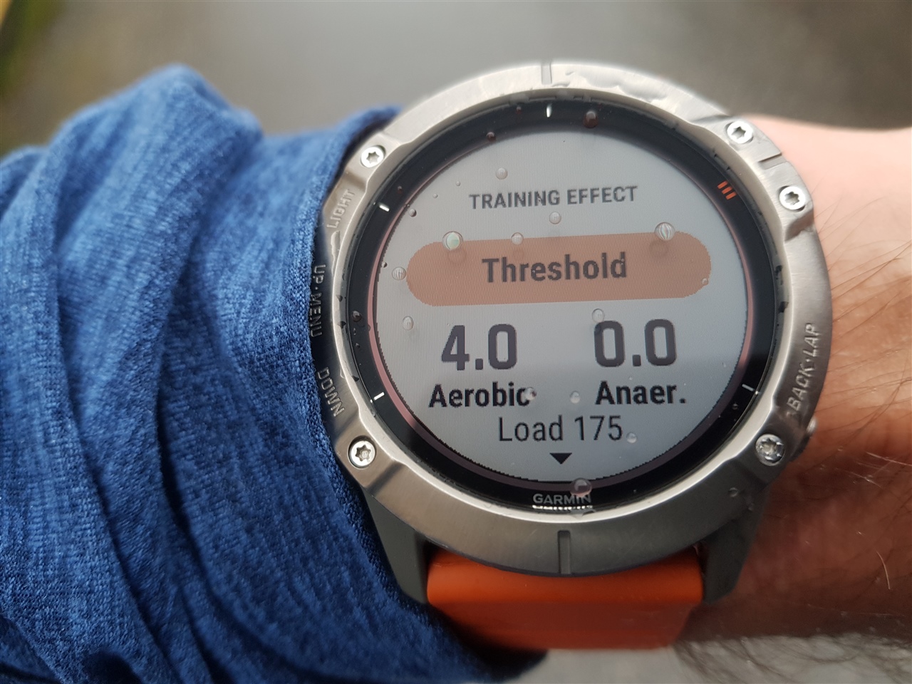

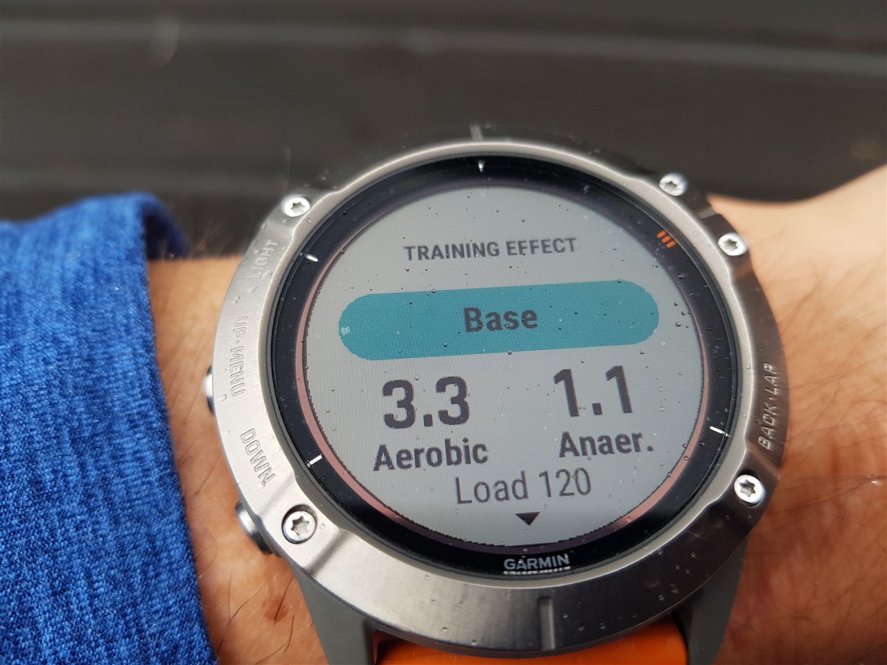

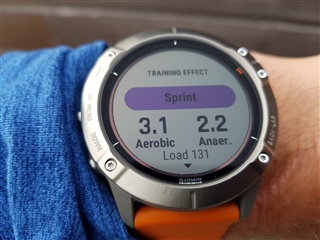

I followed the instructions on the watch and ended up with this training effect result which I thought was strange... I noticed that the speedometer had really long delays while running.

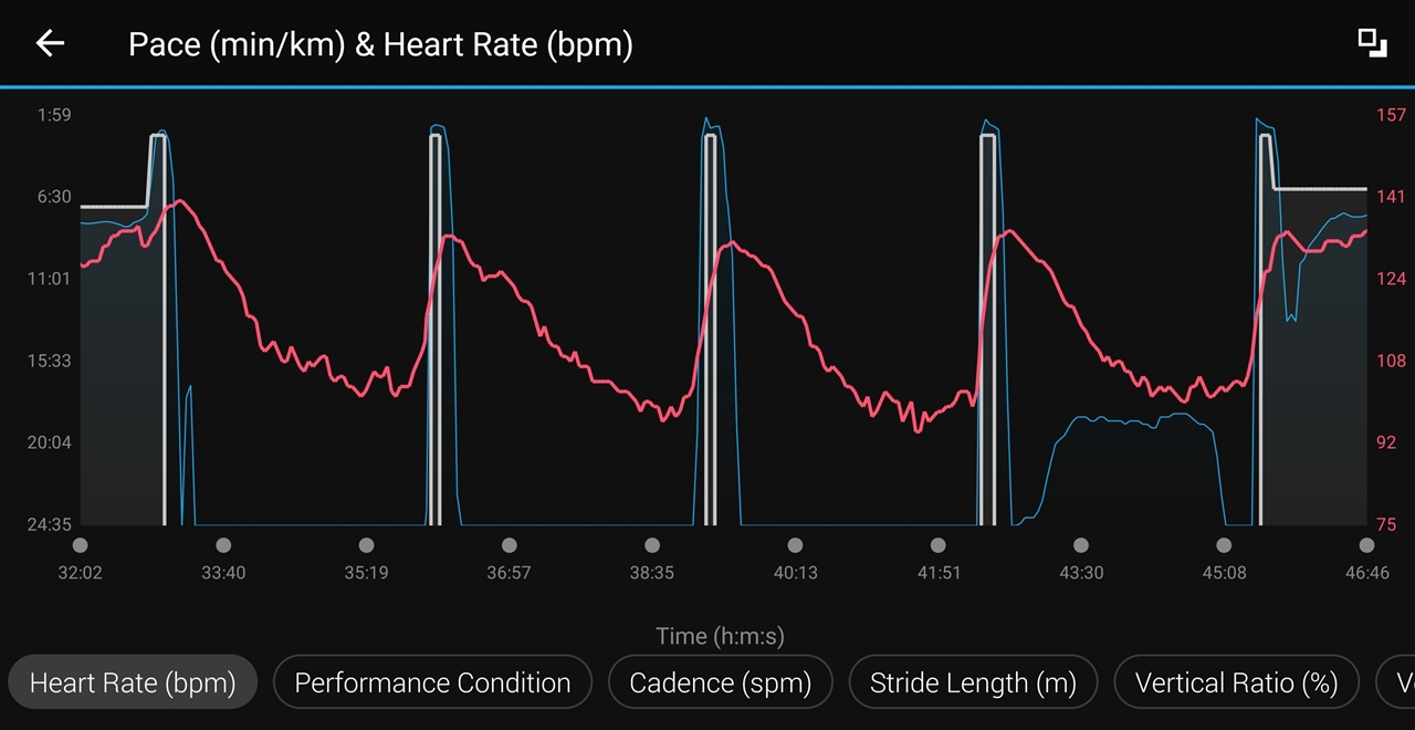

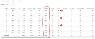

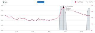

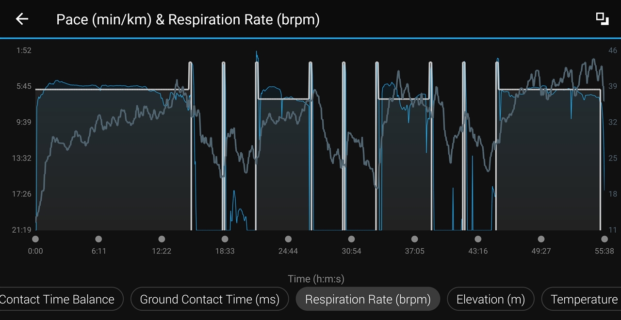

I logged in to Garmin Connect on the web to look at the training and especially the pace diagram which shows targeted pace vs the watch pace. And there it is, the delays are there and mess up the interval training. The gray is targeted speed and the blue line is the pace that the watch shows. Several seconds delays. See this picture:

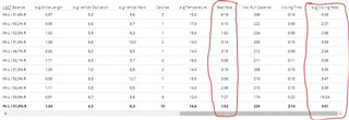

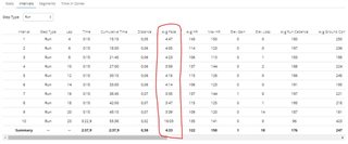

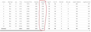

And if we look at the statistics for each interval we can see that the pace is totally wrong...
Garmin, please fix this...

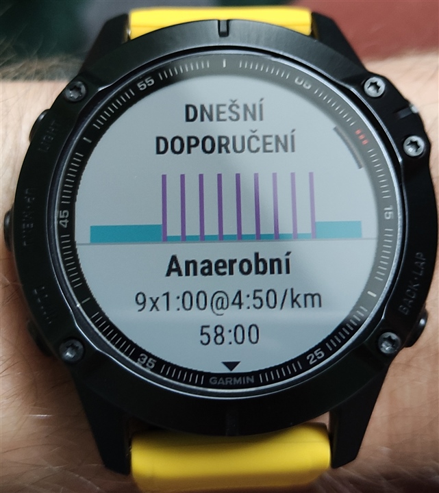

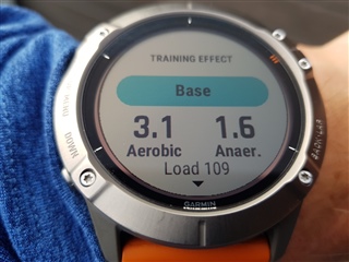

  • I didn't take a rest and tried the Anaerobic suggested workout. I should get 3.3 and 3.3 TE but I get 3.0 and 2.3. Maybe because of a bit slower pace at some intervals. Anaeroboc score I get 0.5/1.0/1.5/1.7/1.9 and then I think 0.1 increase for each next interval.

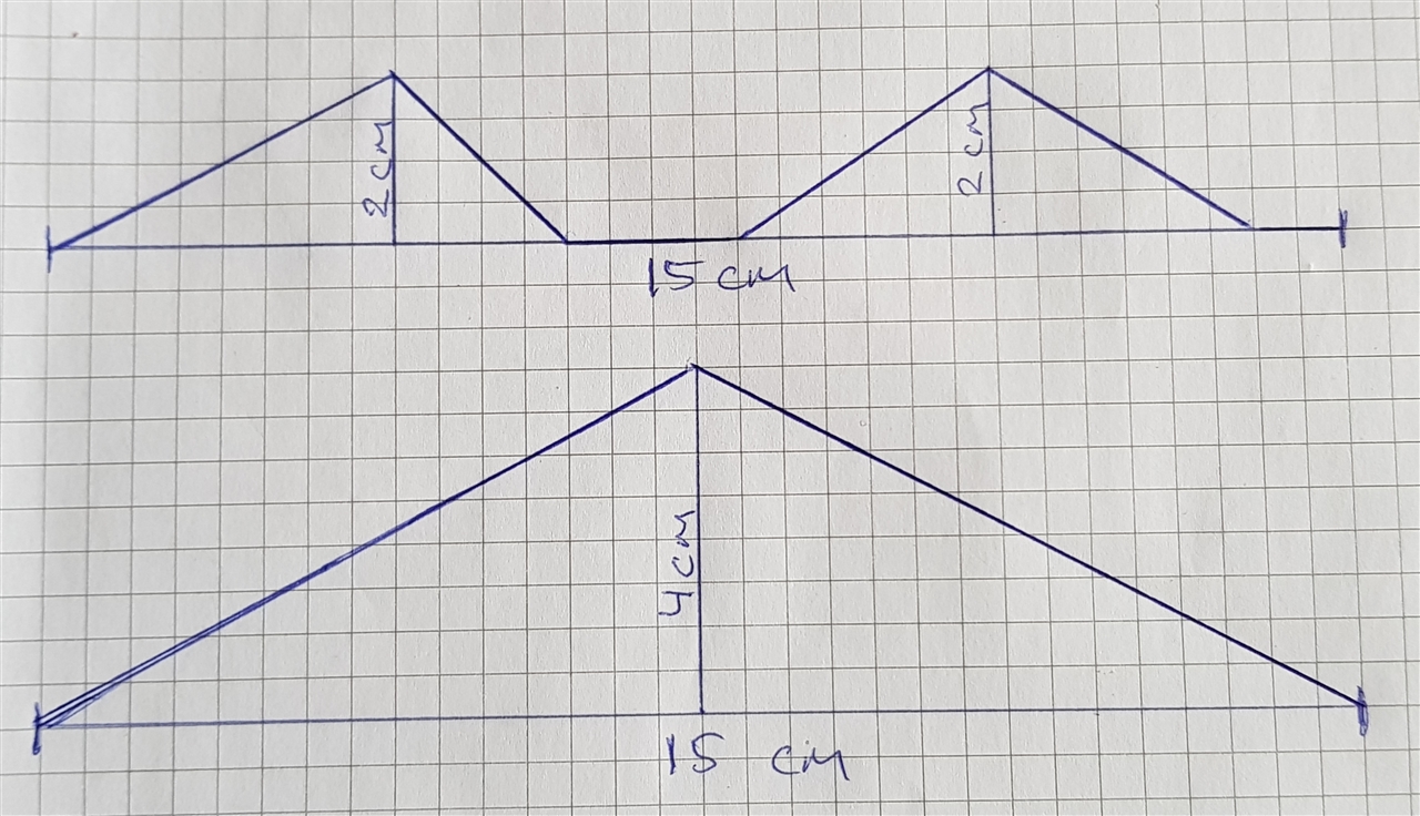

    But where is mentioned in the paper that a delay (shift) of 10 sec between a suggested workout and the real workout has an effect on anaerobic TE? Fig. 8A in this paper depicts not a suggested workout, but the "Theoretical VO2 based on speed".
    Important is not the start of the workout, but the speed and duration. If there is a delay at start of the workout due to smoothing, the same delay is also at the end of the workout. That means it's only a shift and you may start the workout 10 sec earlier. Try it and look what happens.
  • What everyone appears to be overlooking too is that nobody will instantaneously change pace. The acceleration will differ for different people. I believe that Garmin's estimates of training load are based on a step change in pace - going from say 7 min/km to 5min/km instantly. Not going to happen for anyone. Ever. Same applies for slowing down. So there will always be a lag.
    Granted this lag can be exacerbated if there is averaging in Garmin's algorithms but until an individual reaches a steady state pace, the algorithm is chasing a moving target.
    My 0.02c worth? if you're trying to chase a specific pace for a 10 to 15s sprint effort then you're doing it wrong if you're trying to 'game; the system by anticipating the start of the sprint interval. A 10s to 15s sprint should be close to all out effort because by the time you get going, it's time to slow down. Anticipating the sprint is not the way to follow sprint workouts.
