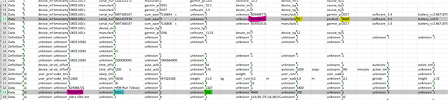

    Just checked the FIT files and the calibration factor is stored along with other info about the FP. I will try to find out when it changed from 99.10 to 100.9.
  • First of all a note to myself; Verify all facts and think out of the box and reflect at least twice before posting otherwise you will have to wear the hat of shame...
    I exported all fit-files to csv since the calibration and to my surprise it has always been 100.9, not 99.10 as I remembered was what I set it to. The only reasonable explanation I have is that I calculated using the formula "(measured distance / true distance) * 100" which is wrong instead of (true distance / measured distance) * 100. The fact that 100.9 was the same as the auto detection got is probably just a coincidence.

  • You can export the original FIT file to CSV using the FIT SDK: https://developer.garmin.com/fit/download/
    In the CSV you will see the total distance in meters.

  • Thank you. That helped me a lot. Did you solve your problem with Stryd autocalibrating itself?
  • Any idea where I can find the stryd calibration used in a Fit file?
    I tried finding it with fit file viewer online but can't seem to find it.
