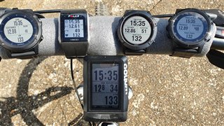

  • I live on the London/Essex border and my experience includes Polar V800, Fenix 3HR, 5X+ and 6X Pro Solar.
    I have found tracks from GPS only or GPS+GLONASS to be the most accurate in terms of tracing the path taken. I have only tried GPS+GALILEO a handful of times because I have never been impressed with the results. FWIW Garmin has chosen GPS+GLONASS as the default setup (I think) and maybe the watch is optimised for that combination.
    I think ththere is little difference between GPS only and GPS+GLONASS in good conditions, but I figure that to use both systems is like having belt and braces in case the satellite view is poor from my location at the given time.
    I can't really comment on accuracy of distance and pace as I use Stryd when it matters. I have conducted multiple tests when walking the dog and differences are there, but usually not enough for concern - for dog walking at least ;-)
    Sample testing setups below....
    Example from today's dog walk. The track shows some bias to the left at times, with the watch on the left wrist, but it is a good track all in all. Dog walks can be tricky, with stop/start to pick up the ball, turning to throw the ball etc.. The absence of random tracks in this scenario is very positive in my opinion.
