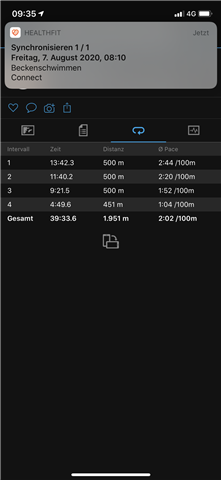

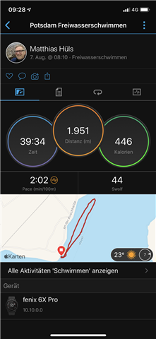

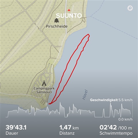

    1. I did an OWS today using F6x pro and a Suunto 9baro. I checked the distance by Google maps to about 1460 m.  Here‘s what the Suunto measures:
    2. and here‘s what the F6 measures:
    3. when looking at details, it seem that F6 is adding ghost distance from 1000 m onwards:
    4. this is really annoying and have to be fixed soon.
