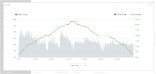

  • Yes. My HR clearly reacts to to climbs, as can be seen on this image using HR strap. This was slow paced hike by my standards, yet HR crests 160.

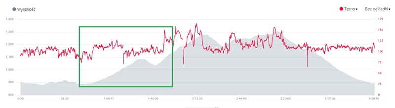

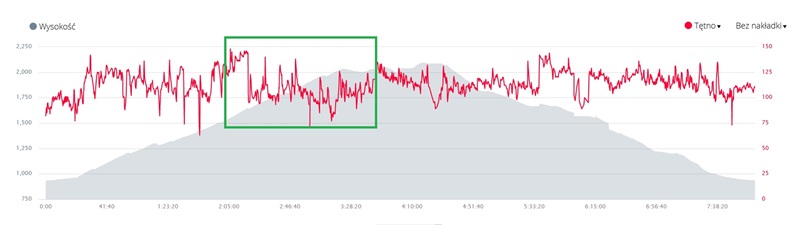

    Here is tough hike in altitude with extreme climb and OHR. There are some random peaks when it goes to almost 150 for a little while, but then it "corrects" back to its usual 120 or so range. Sometimes it seriously drops with climbing.
    Maybe all Garmin Fenix users are anomaly and our HR goes down on climbs? Smiley

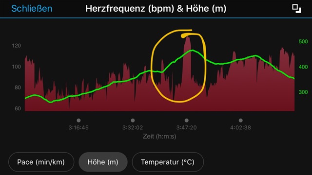

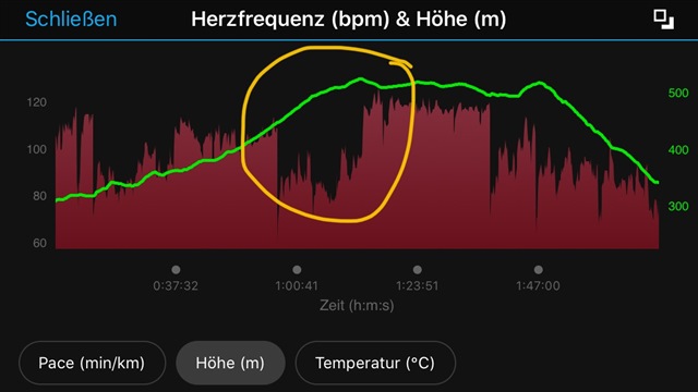

  • Hi I have the same problem with my new Fenix 6X Pro.. First two trainings (hiking) ended up with totally disaster OHR reading.
    After aprox. 40min (maybe earlier but before i did not note) the HR is too low and not appropriate, I checked my pulse manually with marked areas and it was ~140-160 bpm not 90-110 like Fenix showed. Additionally when I noticed that something is wrong I took another Garmin watch (Vivoactive 4s) on the other hand and measure was good and complied with manual measure..
    Additionally, I note that daily HR measure with sleep time is totally not imprecise compare with my previous Garmin Forerunner 235 which shows every day HR picks and correct data. Fenix do not recognize correctly daily HR..
    I expected something more from top model.. Unfortunately I think about returning Fenix because at this time he does not fulfil basic expectations.
    Below included screenshot from activity.
    Anyone maybe has some ideas?
