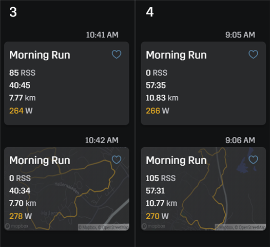

    Did another try yesterday and this time it worked fine:
    I also managed to get the pure Stryd data from friday by going into the app-Debug Options-Files and Re-upload the file.
    It's a minor difference in distance but on the other hand both where on mostly open roads with no trees or buildings.
