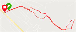

Next some examples of GPS tracks:
(text first, photo after)

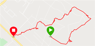

17-04-2020
Fenix 6X
Same route as 12-04-2020, it is through a forest so tracking could be less accurate. Weather was great, almost no clouds.
Fenix 5
same run, different person
And I cycled there with no problem. Upon arrival I immediately stopped cycling activity and started running activity. It still took ~2 minutes to get a fix, but I didn’t notice the fix was lost after a short distance of running

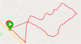

16-04-2020
Fenix 6X
Waited for 1 minute, then left. But kept arm horizontal while running the first few hundred meters. Got a fix a bit later.
Fenix 5X
There was a third person with a Garmin Instinct Tactical. This watch also tracked perfectly fine.

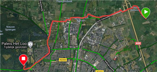

12-04-2020
Fenix 6X
Same route as 17-04-2020, this time it got a quick GPS fix and it tracked the whole route. This day it was less cloudy then 17-04-2020
(contradicts location dependency)

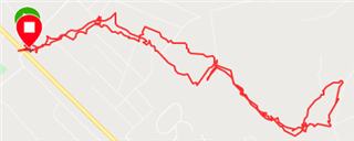

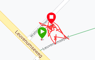

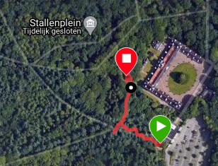

09-04-2020
Fenix 6X
This is a funny one. I wait for 2 minutes to get a fix (at the location you see in the picture) and it doesn’t work. Again I run with 2 other people and they had no problems getting a GPS fix. After the run we do stretches where we started, and I get a GPS fix after stretching for 40 seconds.
Fenix 5X
Tracked perfectly fine, just as another Garmin. But not the 6X.

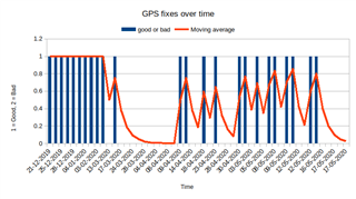

There are enough good and bad examples (you can find them on my connect profile) (I’d guess almost 50/50) of getting a GPS fix, so I’ll stop giving them. Instead, I checked which tracks are okay and which are not (in my opinion) and put it in a table. More useful in the end. You can see the plot of the results below(I can give the table if needed, it's big though). From April and onward GPS fixes are sporadically bad
I can’t really trace which software versions were running in the past, since I don’t see any dates in the changelogs.
But it’s visible that it started working bad somewhere between 03-02-2020 and 13-03-2020.
Because it is so sporadic, and it used to work great before (fenix 5 grade tracking), I believe it’s a software/firmware issue. I hope this may help Gamin figure out what is wrong. Or help other people in their decisions.
