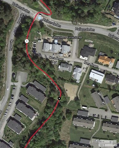

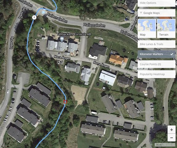

I compared the km markers of the activity, the course and where PacePro said I passed 5km and 8km. For 5km it looks like this:
Course map (red circle is 5km according to PacePro):
Activity map:
It is obvious that the PacePro feature use a different algorithm for distance compared to the activity and that PacePro lacks the accuracy required to use it as a guide during a race. 38 seconds behind a 6:00 pace for 10.27km is a pace of 6:04 which compared to 5:52 is a difference that will have an impact.
