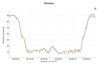

  • I have recently started using the Hike activity to track my dog walks. They are only about one hour duration, so barometric change is likely to be minimal. Here is an example of 6X vs Polar V800 altitude change during a one hour walk.
    I calibrate manually at home from a known altitude and turn off all auto calculations at all times. If I forget to calibrate before setting off the delta for the Hike should remain correct, even if absolute values are offset a bit.
    FWIW if I remember to calibrate every day (I don't) I typically find that I only need to adjust by 3-4m max, often 0m.
