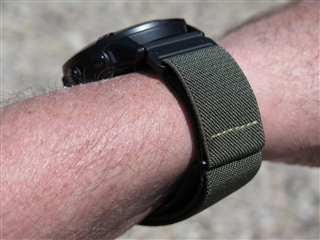

I use an elastic watch band, the downside is that this band can hold onto the spring mechanism and compress the watchband-pin so it opens.
I used this watch band for a half a year and it never happened, but it happend twice in one day now, first while carrying some stuff where I had to push my hand inside a sort of tube and it opened the lower pin.
Then later in the night it opened up the top pin while pulling my hand away from under the pillow. My first thought was, ok the non original replacement pin sucks (the lower one was lost during the accident earlier), but it was the other one that opened up, the remaining original Garmin one.

- elastic bands (like Nick Mankeys) can catch them-self in the grooves meant to release the spring-bars and pop them out if stretched in an unlucky angle

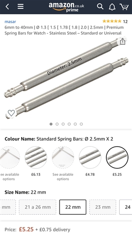

  • Ok 1,8 diameter at the end sounds good, now if only the ends would be flat/smooth so the elastic band couldn't hold on, but they look like the original ones.
  • Spring Bar, 2.3mm OD, 22mm
    Spring Bar, 2.3mm OD, 26mm

  • I’d venture to say that you’re using a Nick Mankey strap. I have the same band for my F6 and the only way those pins would pop out is if you had the band too tight. The pins are very strong and the strap is very flexible if worn properly.
  • As mentioned in this thread the Garmin design is bad with elastic bands.
    Wrong way round. The 3rd party elastic bands are poorly designed to work with Garmin pins.

  • Well 22mm is good, do you have a link? I tried Google but obviously with bad keywords.

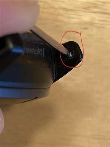

    I’d like to bring your attention to this picture where it compares 22mm Garmin bars vs standard spring bars:
    Notice the ends? That’s the issue, it’s also an issue if you’re trying to fit the QD strap over it because there’s still a gap between the QD lever and the end of the band.
    Now, I took off my stock bar and tried a basic bar and you can see the gap between the end of the bar and the hole:

  • The challenge here is to find spring bars, where the end tip is 1.8 mm
    The ones I previously posted a link to on Amazon UK have 1.8mm dia ends.  The issue is they may be too big in the middle with 2.5mm dia, rather than the Garmin 2.3mm. So that could potentially be an issue with QuickFit bands; although my F6X 26mm QuickFit bands slot fine on and off my Fenix 3 with the wide diameter torx screw end bars (so I suspect 2.5mm dia would be OK).  I don't think the Garmin pins are 'non standard', so as @philipshambrook previously mentioned, if you need replacements it may be worth having a chat to a good jeweller.  As to whether you can get these larger diameter pins without the double shoulders at each end, again a good jeweller may be able to find out.
