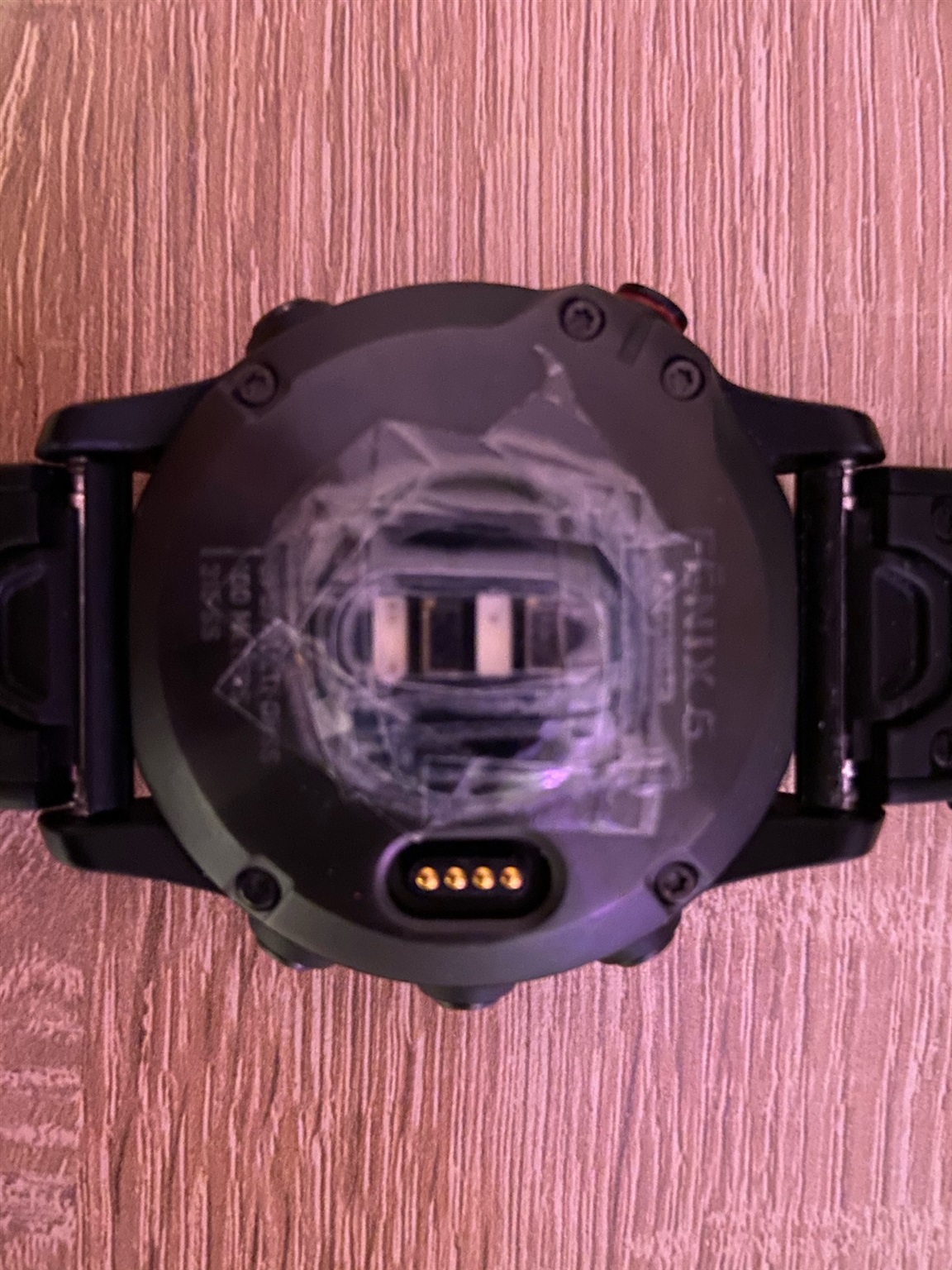

Hi guys! Recently I made an upgrade from Forerunner 645 Music to Fenix 6 Sapphire and I see it was a bad move. I have big issues with wrist HR. Fenix 6 seems to have issues with my sleeve tattoo. When the OHR sensor seems to be in place which is darker it turns off completely and doesn’t measure anything. It thinks I have taken the watch off my wrist. If I put in in lighter place of tattoo it turns on again. As I wrote before I had F645M before and had zero, completely zero issues at all. I know there is info that tattoo may impact measurment, but the older generation of sensor had no issues with that. Is there any possibility to force OHR always on? I love new Fenix 6 functionality and design, but it is mostly useless in this case. Anyone with similiar problems?

  • So, after reading this forum about all the issues with WHR in Fenix series I did a little experiment. I put a little piece of transparent plastic on the sensor and now it is working over tattoo. Readings are more or less the same compared to my old Forerunner 645 Music. Garmin really? It seems this plastic forces to use more light by the sensor and it just works. Probably will drain a little bit more battery, but it is not such problem for me. Imo there should be some high power option for WHR for people with tattoos and/or dark skin.
