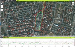

WALK activity

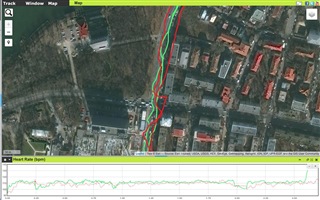

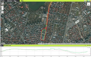

the results are pretty damn close. Slight advantage to Fenix6 for faster initial GPS lock and somewhat better tracking. To be fair, i think Fitbit's taking some time to do the first ever GPS lock for a new device (they have a support article on that), but subsequent usage should be faster. Will test more over the next days. Also i noticed the Fitbit GPS track is accurate but is displayed somewhat shifted on the map itself. I've noticed this on garmin connect as well if one chooses openmaps or google maps. Not a dealbreaker. Both better than AW (assisted) GPS tracking which cuts & rounds corners in a frenzy.

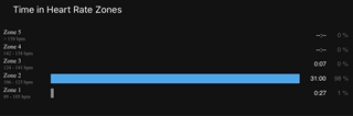

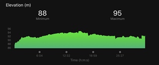

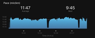

Fenix 6:
Charge 4:
CONCLUSION:
Time in Hr zones identical
Average HR almost same
Pace faster on Fitbit
Distance more on Fitbit
Total time more on Fitbit
Elevation gain almost the same
Min/Max HR pattern quite similar
More calories reported by Fitbit
Altitude values quite off between the two (Fenix 6 altimeter/barometer were manually calibrated using GPS few hours before)
Fitbit got GPS lock about 20-30 seconds later than the Fenix6 (as i already started the walk), which COULD explain the differences. As i said, i'll test more later on.

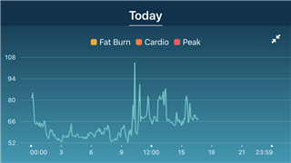

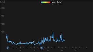

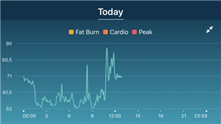

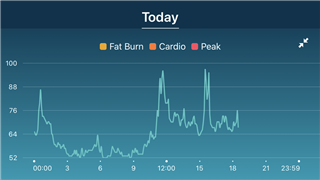

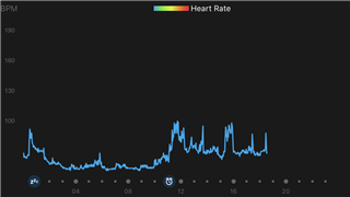

OVERALL DAILY HR
Fenix 6:
Charge 4:
CONCLUSION
I'd say quite mirror-like except one spike which looks more exaggerated on the Fitbit. Dunno, hand movement, band placement or something else.
Will be tested also for few days in parallel.

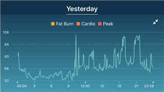

  • ALL DAY 24/7 HR
    Fitbit:
    Fenix 6:

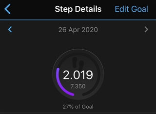

    Here is a STEP COUNT comparison from today
    What i noticed is that outside a "walk activity", both devices are pretty close. As soon as i have a walk, the values get more on the Fitbit (reflected in the total distance of the workout vs. the Garmin one - which also can influence the calories burnt count above).
    Keep in mind that Charge 4 is on quite new firmware, there's room for improvement here. I'm not quite happy with the GPS track recorded, it seem to wander more than the Garmin one which is ROCK solid most of the time.
    What i also did 2 days ago is i switched the devices around. Initially Fenix 6 was on left hand, Charge 4 on right (with dominant setting). Now i have Charge 4 on left (with non-dominant setting) and Fenix 6 on right. I don't have a sensitivity or left/right hand option in Garmin Connect (except the backlight on-gesture, i think)
    EDIT: i found out why Charge 4 steps seem to go off compared to the Fenix 6 during/after a walk workout (which uses GPS):
    https://help.fitbit.com/articles/en_US/Help_article/1141
    When you track an activity with GPS, your device calculates your distance using GPS data rather than steps. If you begin moving before you get a GPS signal, your device calculates distance using your steps until GPS connects.

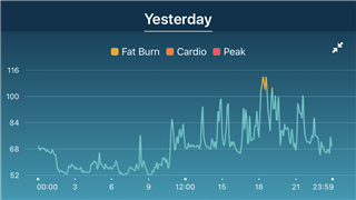

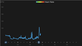

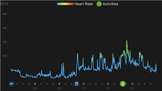

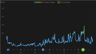

  • Three more comparisons: All day HR yesterday, Overall HR today & Sleep last night
    ALL DAY HR COMPARISON (previous day)
    OVERALL HR (today)

    Conclusions
    - Average HR identical
    - Stages on Garmin all over the place (light & deep way off)
    - SpO2 looks similar on both
