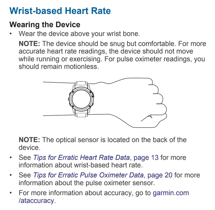

From the manual -
"You can set the device to alert you when your heart rate exceeds a certain number of beats per minute (bpm) after a period of inactivity."
In other words you need to be inactive, immobile, not moving with an elevated heart rate above your threshold.

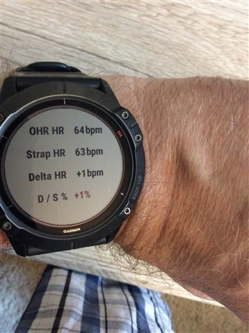

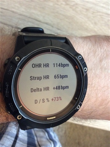

all right, you can't actually test that. I am only worried that this function will not work for me, because I have not yet managed to get the watch to display more than 111 bpm without starting an activity. But maybe my sensor has a defect.
Set a lower threshold.
