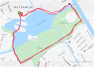

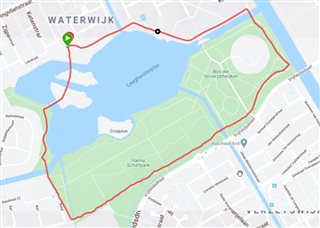

    More sginificantly is the difference between 2 different Garmin watches, like other people have stated also. Below the tracks i ran with my girlfriend this morning. Captured from the Garmin Connect web interface. On the left side, her Vivoactive 4, the right side my Fenix 6, doiing 2 laps.
    I do not mind my route beiing somewhere off for 5m (can't have it all from a 1,5" piece), but i do mind the significant difference between the 2 devices. The smooth Vivoactive and the wobbly Fenix 6 Disappointed
    I have asked Garmin's customer service about this. They responded with "ehm, this should not be like this" and suggested to swap the watch for free. Good service, but it will not solve the issue, i guess. In respond I asked them, with the 2 GPX files send, if there will be a solution for this shortly.
    Is this an issue we wille have to live with because of the Sony chipset, and the metal bezel/cast the F6 is made of?

  • The top image is two laps from a Vivoactive 4, is it correct? Since it uses the Sony chipset too, and has a metal bezel, it's interesting to see such a difference Thinking

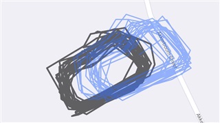

    To 'answer' you in another way - during the past 21 days a Polar Vantage M and a FR 645 traveled around my house (lock down) every day, approx 27 laps / day at the same time, basically following the same footpath.
    The Polar (by implication the Sony chip-set) is with every run quite true to the real track while the offset of the Garmin 645 is again visible with every run, see attached example.  (My house is not in the street :) )
    BUT - interesting, I have NOT found this (offset) with my F6s, it is tracking very close to actual.
    Black = Vantage, Blue = FR 645:

    The image with 2 laps is from my F6 pro, 1 lap is from the Vivoactive.
