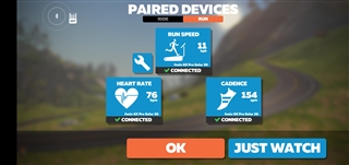

This screen print is from my Galaxy S10+.
