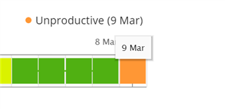

This morning before the run my Training Status was productive with low aerobic shortage... so i decided to run base run which is slower run compare to tempo and then it change to unproductive.
what is the point of the training status if it doesn't recognize im doing slow run on purpose?
  • For the slower runs the watch expects us to have very very low HR values. Since we do not (for whatever reason) it thinks our fitness has dropped

    You went and did a run in a zone in which the data suggests you are (currently) undertrained in. And unsurprisingly the watch reported a poor performance in that zone. It seems to me that the watch is performing exactly as intended.

  • It’s likely unproductive because you are short on low aerobic and above on high aerobic activities.
