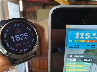

Last week I had a treadmill walk/run of 1 hour. 6X OHR tracked very well with a chest strap paired to my 5X+
Following that activity I stopped recording, but started another run/walk with the 6X on the watch face. For the first five minutes the 6X was nowhere near the correct figures, but then it closed the gap quite well for several minutes before I returned to walking to cool down. Once walking the numbers from the 6X became more and more absurd, reaching a low point of 50 BPM while I was still walking and had a true heart rate above 110. I can't present a graph, as there is no recording fit file, but here is a photo showing the ridiculous value on the 6X vs reality. This was towards the end of 27 minutes of continuous run followed by walking.
I reported the problem to Garmin in December. It is my video linked earlier in the thread. Garmin does not dispute the problem, but also has no solution to offer.
The watch is simply wrong. It needs a fix and it needs people to report it to Garmin to gain the traction it deserves.
