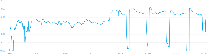

Made now a run after the GPS Update 4.01
Instant Pace was pretty much spot on. no glitches and way to high "current" pace anymore - this feels correct for the first time. Also the Track itself looks more precise.
Lets hope that it was the update and no lucky Satellite situation.

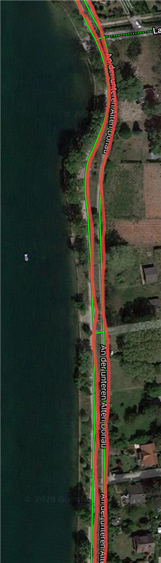

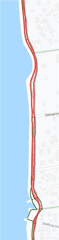

Worst track ever today, GPS + Galileo 4.01 GPS Fw, 7.77 beta, 6X Solar.
Light green mixed to red is the actual gps track, blu is where track should have been...

Very good track! Which model? Which satellite settings? Where do you live?
