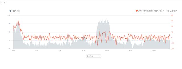

I got curious after seeing some people complaining about differences between OHR and strap HR readings so I did a wee experiment.
From another thread in the F6 forums and using a data field I found on the ConnectIQ store I put on my strap, configured the data field and got these results (see photo). My results where also very similar while in activity (+/- 4 bpm )but as I don't carry my phone with me no photo so you'll have to take my word for it.
Try this yourself and post a photo of the results. Please show how you wear the watch as well.

    looks good for rest and a light effort (around 100bpm).
    what I spotted is HRM strap is more sensitive (react immediately ) to an increase/decrease, optical HRM has a delay a latency, but not much, and cope finally.
    please keep in mind that we compare apples with orange - optical vs electrical measurements.
     the last image is immediately after I stopped running (in da house)...#stayhome
    the optical has a little latency, but in seconds went near to strap.

  • As others have mentioned, the difference is negligible when resting but becomes an issue when my heart rate is above 100bpm - the OHR just doesn’t seem to like recording higher values!

    ...higher values came with sweating, bumping, vibrations, the watch moving on the wrist...to be taken into account.

  • checked WHR vs ANT+ Strap on my Garmin 6X Sapphire (Firmware 8.73 - Sensor 5.06 - GPS 4.1 - ANT 5.01)
    Jogging: almost equal data (tested 4 times)
    Hiking: WHR data often much to low (tested two times)
    during hiking especially on slopes the WHR is much too low (50-70 beats lower then strap)
    maybe the differences jogging (WHR reliable) vs hiking (not reliable) is caused by the position of the arms. Runners triangle when jogging (arms up) and arms down when hiking....
