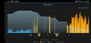

On the subject of body battery and stress, my BB declines during indoor cycling and treadmill work, also during my Move IQ dog walks each day. However, following the activities my stress measurement does not resume for maybe an hour or even two. If I try to obtain a stress reading by opening the widget I get the 30 second count down and then usually the message "check watch fit", with no result.
The watch fit is 100% not the problem. My live heart rate continues to update, but stress is AWOL. During this period my body battery is flat lined. If I reboot the watch the stress measurement resumes immediately, with no adjustment to the watch on the wrist, and body battery drops off a cliff as though to catch up on the missing stress data influence. I reported this to Garmin yesterday and have sent in files and screen prints as evidence.
Maybe there is a lot wrong with stress and body battery, possibly with different outcomes, but broken nonetheless. These behaviours were not present when I first got the watch in mid December, so maybe a sensor or firmware update has upset things. I'm currently on 6.00 firmware and 4.20 sensor.
Example from 6th Feb. I rebooted the watch at around 17:30 and immediately my stress data resumed, and body battery adjusted. This is quite hopeless.
