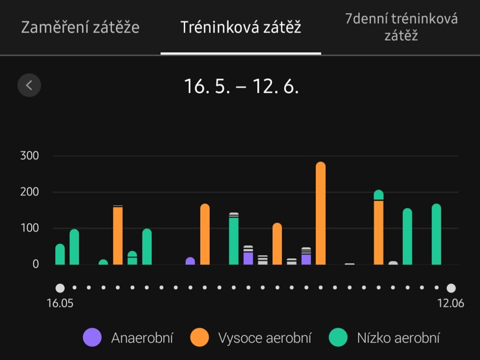

  • Prolonged duration of zone 2 exercise seems to push the entire load towards high aerobic
    That isn't true. Yes, what you describe may happen due to cardiac drift, but many of my multi-hour trail runs end up benefiting Base and having low-aerobic impact.
    For example, I did a 7+ hour 30 mile trail run a week ago. Aerobic benefit was 5.0 and low-aerobic load - 342. Average HR was 127.
    I actually have zero problem getting the recommended low-aerobic load. More often, I am low on high aerobic load. And I am always very low on anaerobic load.

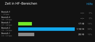

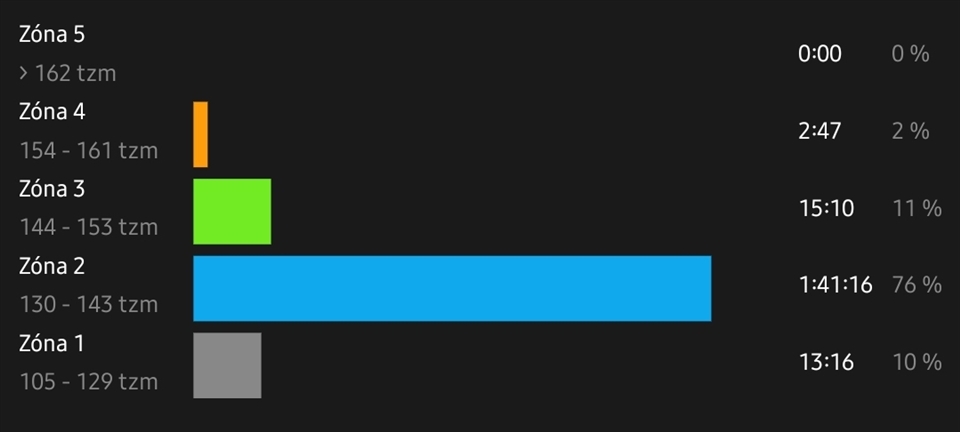

  • It's definitely HR and Zone driven. But, the weird thing is if your zone 2 maxes out at 130 and you spend 1 hour there, you get very little low aerobic. If your zone 2 maxes out at 150 and you spend an hour there you get plenty of low aerobic.
    My conclusion after solving this issue is that the zones are not correct as a default. The fix for me was to set my heart rate zones using % of max, rather than the default. Before doing this, zone 2 for me was barely a fast walk and I felt like I was doing nothing, my breathing was not even elevated. Switching to the other option shifted all my zones around and not only did Zone 2, sometimes known as "Easy" feel correct, as I was just starting to breath and able to slow jog but my low aerobic points started coming in much more abundantly. Now when I follow the garmin program to the letter, I get a good mix of the three loads. The warm ups and slow runs are enough to keep me balanced.
    In short, either manually adjust your heart rate zones, or like I did, select one of the other calculation options through the app.
